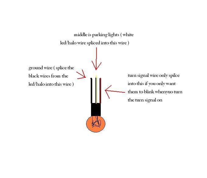

what was the color of the wire you spliced to to get the halo's and leds on but not flash for the turn signal? Is that my understanding of what you wanted to achieve?
ok i spliced into the the wires right behind the park/turn signal light bulb. If its all stock like mine the middle wire should be black/yellow that's the parking light wire.
the black wires from the led/halos are grounds
the white wires from the led/halos are the hot wires
this should clear it up

and if you have a problem with the lights not changing from highs to lows and the high beam light in the truck stays on AND the high beam lights are really dull at night ill walk you through the way to fix that too.let me know if ya need more help want to see pics too when done!
