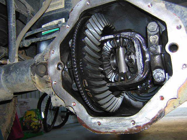

try looking for a paper tag on the drivers side rear axle tube. look for 3.55 OPEN, which is not limited slip.
another way - remove the diff cover and look for the broken clips in the bottom.. haha, sorry, i couldn't resist.
stand by, looking for a pic.
edit. damn squirrel beat me to the post.
this is OPEN. note the open carrier with spider gears at the top and bottom of the pinion shaft

Originally Posted by aim4squirrels
check for a sticker inside the glove box.
or
jack up the back of the truck and support the axle on stands, spin a tire, if the other tire moves the opposite way, you have an LSD
Don't you mean it has an open diff if the other tire moves the "opposite way"?
If it were a LSD both tires would move the same direction when you spin it.
