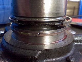

Well, after dropping the trans again and pulling out the oil pump (I suspected the metal was from a broken seal ring in the pump), here's what I found. I guess when my cousin put it in, he used a bit too much force and broke the pump. So I went back to the trans shop and got another one and popped it in. Now that it is all back together, everything seems to be alright except for the fact that the trans pan now leaks thanks to the drain bolt I put in it. I can't get the damn thing to seal.
Therefore today I am putting in a new trans pan to take care of that and then I should be all done with the trans for quite a while.
