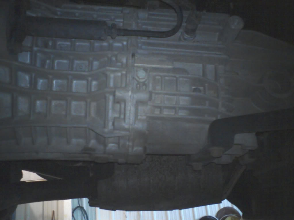

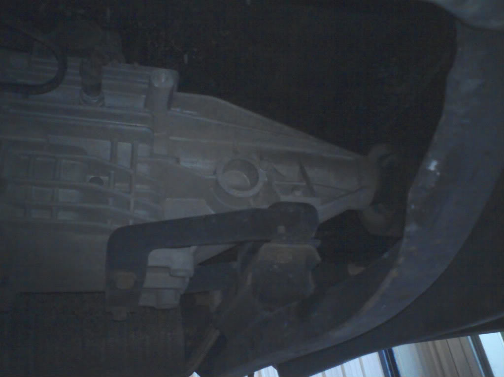

since people were wondering...

i'm gonna laugh at myself if it's not a NV4500... haha
my hood has a slip on it from dodge stating that it has a HD manual tranny

Better start laughing! That is the NV3500.
Ill get you a picture of the NV4500 today.

Here ya go. Minus the input shaft and bell housing. This one was built but i needed the input shaft for another one so i robbed it.
A dead give away for the 4500 is the cast iron case, large shifter top, removable bell, and PTO ports.
The way to spot a 3500 is the all aluminum two piece case, bolts down the middle.
