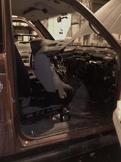

I went through a lot of this myself. The final straw was when I started plowing this winter. The engine temperature was over 200 degrees and there was not enough heat in the cab to keep the side windows from freezing over (on the inside). I couldn't see to plow the parking lots.
I have a copy of the factory service manual and read over the procedures to replace the heater core. The A/C lines have to be evacuated and whole dash has to be removed (see picture). I replaced everything in the heater box at the same time (A/C evap, heater core, blower motor) because I wasn't doing this a second time.
In total it took about 8 hours. My friend helped and he had the equipment to handle the A/C refrigerant. I can't imagine what the dealer would charge for the labour. I bought all the parts from RockAuto and the pricing was pretty good.
Now I can plow with the windows rolled down and still be sweating in the cab. The heater core was partially plugged and the motor was next not spinning very fast.
My suggestion is to bite the bullet, find a place out of the weather and replace everything in the heater box. The job is not difficult, just time consuming.
Take lots of pictures and notes while taking everything apart. Reassembly will be really easy. And yes, that really is the dash sitting on the seats in the picture.
