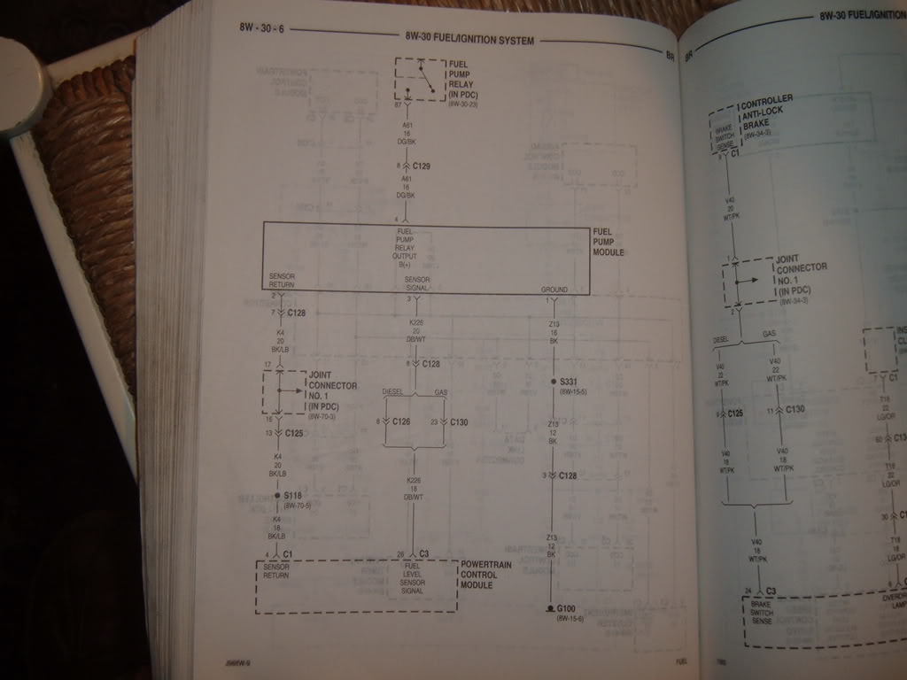

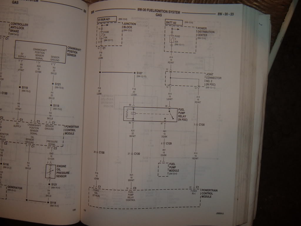

Still looking for a wiring diagram for the fuel pump/sending unit... Not able to download the file that zman17 posted.. (I'm on dial-up...heheh!)
Surely someone can help me..

I give up...Apparently the sending unit is bad. I have treated my fuel with Techron Concentrate Plus for 3 tankfuls and no difference. I can live with the gas guage going crazy, but I cannot live through another day with the low fuel chime dinging everytime it drops to empty.
When I get the time & money I'll have to replace the sending unit/fuel pump module.
In the meantime, where is the (expletive) chime located so I can either take a hammer to it or yank the (expletive) wires off...... I'M GOING BONKERS!!!!!
