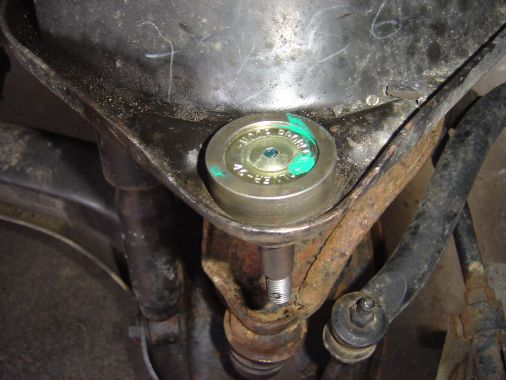

on a stock c-arm this is the way i put it in....
the part you put the wrench is up... pointing to the fender
me more help let us know... i also have alot more pics to help

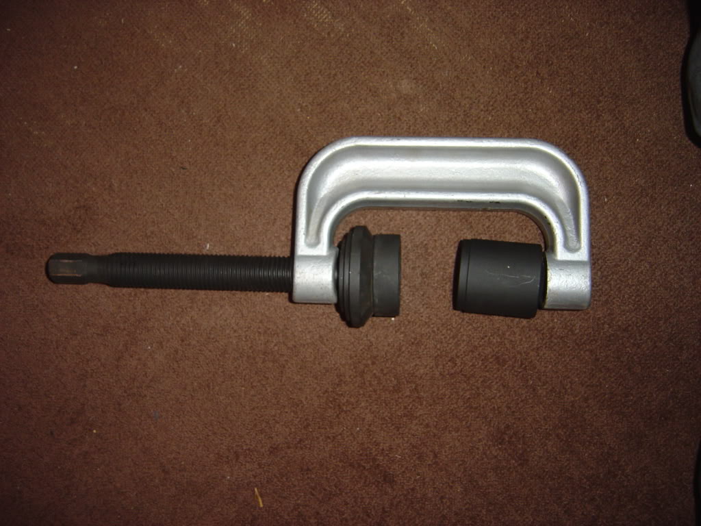

I'm talking about the upper arm, it's a fabtech. The instructions say to make sure the snap ring seats fully. I have the press kit in the pic above. I've put my whole 260lbs into my 2' breaker bar and it won't press in any further, so that snap ring isn't gonna go in. I'm thinking that since the old arm didn't have a snap ring, and the factory arms don't have snap rings that I'm not going to sweat it. Press fit is press fit, right? As long as the bolt on the other side of the spindle is tight it's not like anything can fall off, right?

correct... i don't know why your top joint has a ring.... but your right it can go no were...
mine didn't
