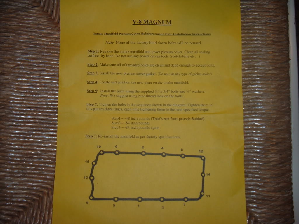

I know its a shot in the dark but do any of you hughes repair kit guys have that paper with the sequence and how much tq you use on the bolts? Also if I pull it can I reuse the metal gasket that came with the kit or do I need to get another one?

Well, I have a brand new Hughes sitting here that I have not needed to install yet. So I can give you a pic of the torque pattern, but as far as reusing the gasket, I wouldn't do it even if it says you can.

Here's the pic , but can't you get a couple new bolts or a tap to try and clean the threads?
