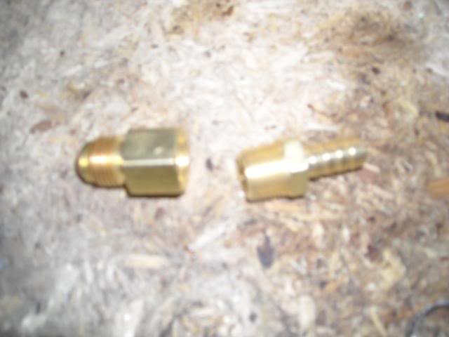

3/8'' flame to 3/8''FIP converter and 3/8'' MIP Barb is the Check Valve Delete.
I would also add an external filter, like I did.
