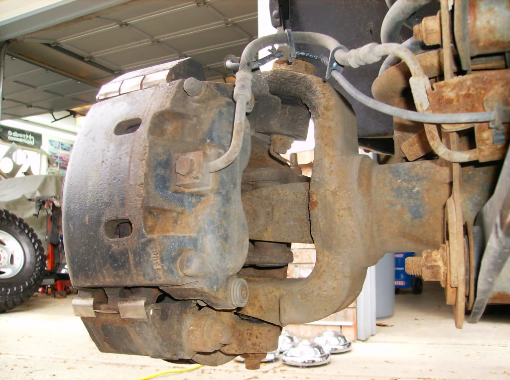

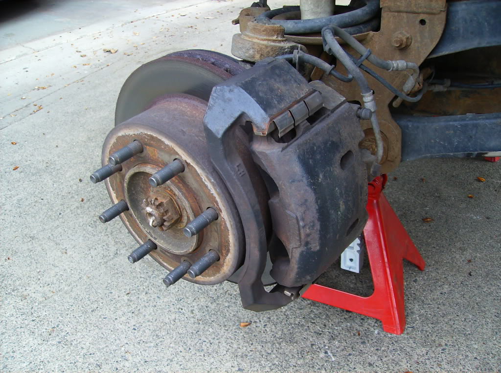

If anyone has pictures of a 2000-2002 2500 with a dana 60 in the front. I would love to see them if you could please. Im currently working on a project and my towns junk yards are all out of them. What im looking for are pictures of the knuckles and brakes. I know they switched to the two piston calipers and have been told that the ball joints are mounted different starting in 2000. Just would like to see the difference. I have a 96 front 60 and know what that looks like. Just want 2000 and up. Thanks.

I'm pretty sure helm's truck is that new. He's quite a helpful fella, I'm sure he will set you up if he see's this thread.

ill snap some shots tommorrow, i need to rotate my tires anyway, lol
Old Apr 11, 2009 | 02:44 AM
Kraiger's Avatar
Kraiger
Joined: Feb 2009
Posts: 402
From: OHIO
Thanks a ton Helms....but thats not what i wanted to see.lol...yes the ball joints are different and i cant just swap knuckles to do the dual pistons....looks like id have to change the C's...and Olyeir...yup thats me..lol...im staying with the stock set up i guess..but got half the lift done today and will finish tomarrow afternoon....ive got some good pics and ill get some more before it gets covered in mudd..hahaha....ill try to get them up sunday....thanks for the help guys..
