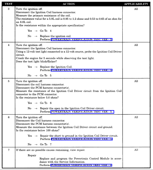

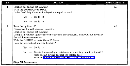

the tests for the p0351 are really simple, you can do all of them with a multimeter. it isnt complicated when you get in there.
