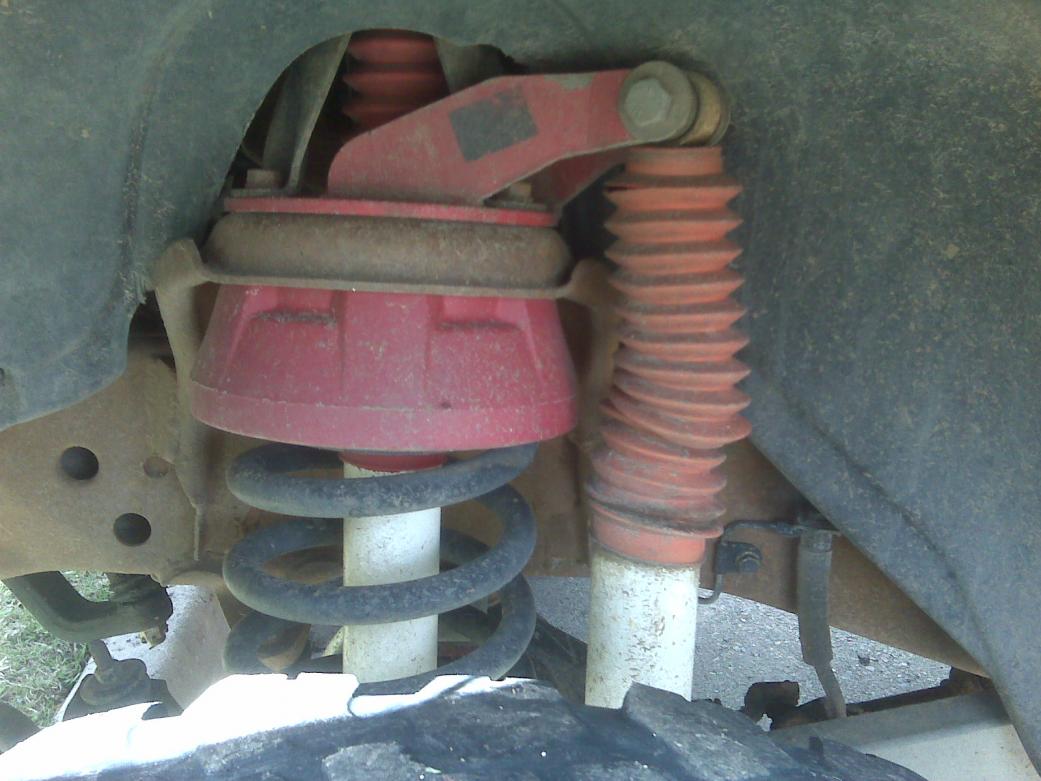

Here's a pic of the upper spring perch and shock mounts I snapped on my way out of the office. I'll take some of the Control arms tomorrow when its light out.

Well, you at least have 3", cause that is a 3" coil spacer. Looks like a Rancho one.

thanks. Assuming thats all thats there what size tires can i fit with 3" of lift?

33's fairly easily, 35's with a skinny wheel. But, unless you have regeared, stick with 33's max.

I like that dual shock setup

yep its a rancho 3" coil spacer. just put one in my buddies truck! i fit 33" under mine with just a 2" spacer (pic under my name is with that setup). but the 35" did not fit. so i had to get a 6" lift
