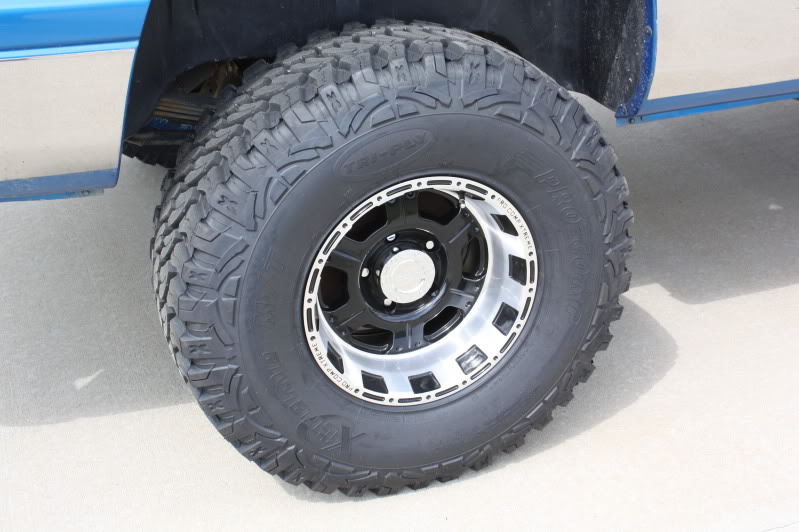

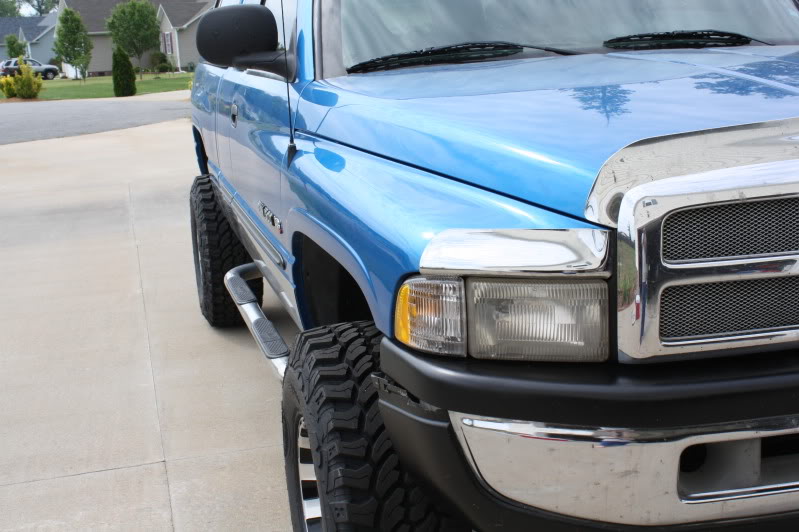

Hey guys I got a favor to ask, I just got done putting my used lift and tires on and I know I need alittle more on the front but my question is how much to make it level. I purchased a used 3" skyjacker lift, when I called to find out what the height of the springs are brand new I was told that they come 21" and 20.5" and mine were 19" and 18.5" so the springs have sagged. So the front is still raked and I rub at full lock with my new 35's. I measured from the top of the tire to the fender and I am getting 21" in the back and 19" in the front. Do you think I need a 2" spacer to level it or will that be too much? Could anyone take some quick measurements for me to see if you are some what close to that or if your front and rear fenders are the same size opening.
Oh and here are some pics. I really like the rims and tire combo. The tires are Procomp Xtreme Muds and are not to bad, alittle howl but nothing to bad.

Well thats the thing, I found 1', 1.5", 2", and a 3" spacer but I dont want the front to be raised and have that nose up look. The roof and the nurf bars look to be able level with the ground in the pic but I dont know.

It looks to sit about level now. I'd say probably the 1.5" as well.
But even with that, with 35s, you'll probably still rub on the front wheel well. You'll still need to make some adjustments.
