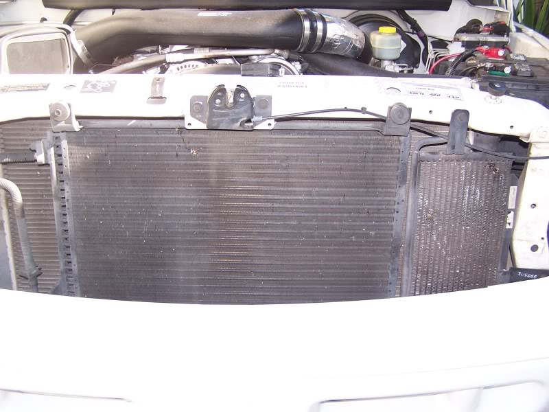

This is the radiator (behind the A/C condenser and tranny cooler).
It is 36" wide by 20" tall.
If you think you can shoehorn this monster into your '85, I'd love to see it. Sounds like you already made up your mind, so I have to wonder why you bothered asking the question.
