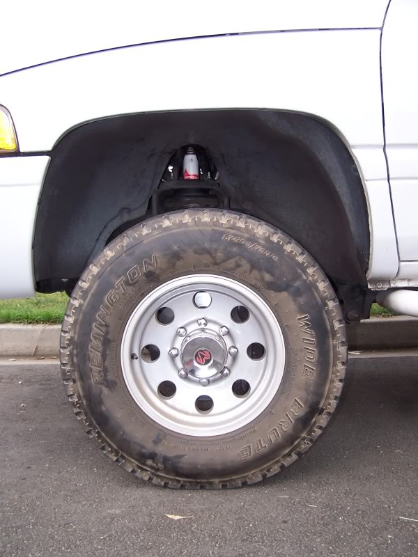

This is the front of my 2500 before and after the 2" leveling kit:
My tires are 31-1/4" tall. I don't think I'd risk 35" tires on this setup. 33s will probably fit just fine.
