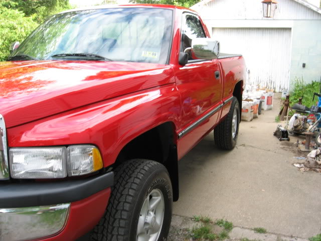

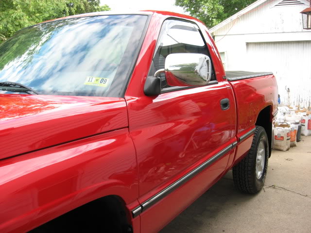

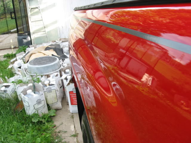

What do you guys thank I thank it looks damn good for a 95

are they all the BUCKETS of wax in the background?????
Haha
Nice job looks awesome..

nice job !!

wow man that turned out damn good! I'm tryin to get up the ambition to try buffing mine, and this definitely inspires me to get off my *** and do it.... how long did that take to do? and what all did ya use to do it?

Well my dads friend owns a detail shop so I did it there I took like 2 hours to buff it BUT IT WAS MY FIRST TIME. I used 3m perfect-it 2 Rubbing Compound the number is 05973 with a Circular buffer. BUT BE CAREFUL YOU CAN BURN THE PAINT but if you keep it moving you will be just fine. After I buffed the whole truck I washed and dried it. Then I waxed with mothers California Gold wax I am very happy with the results.
PS: you can get a Dual Action Orbital buffer that will not burn the paint but it will not do as good of a job if you want to watch some videos of buffing go to this site http://autogeek.net/bupo.html This is all the buffers thay have
This is a guide for Circular/ Rotary buffing http://autogeek.net/buffer-polisher.html
This is the guide for Dual Action Orbital buffing http://autogeek.net/dual-action-polisher.html

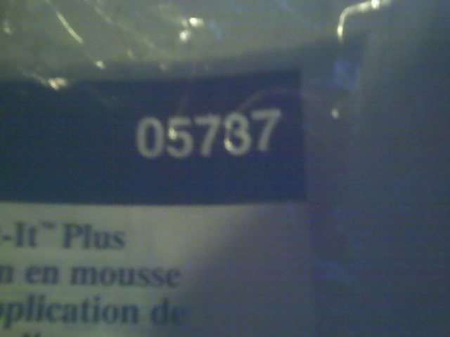

Here is pics of the rubbing compound and wax
