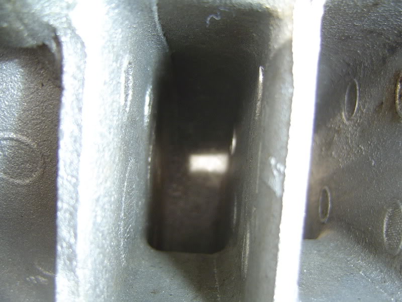

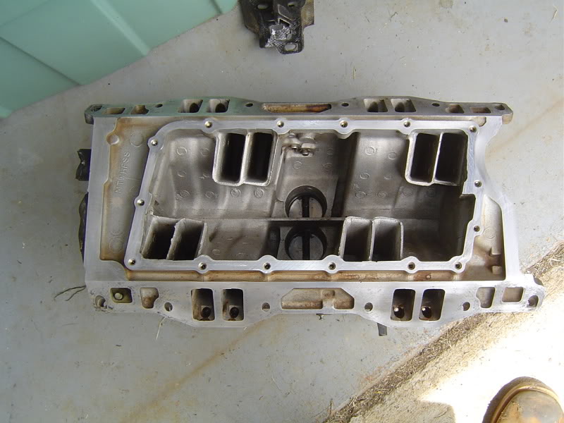

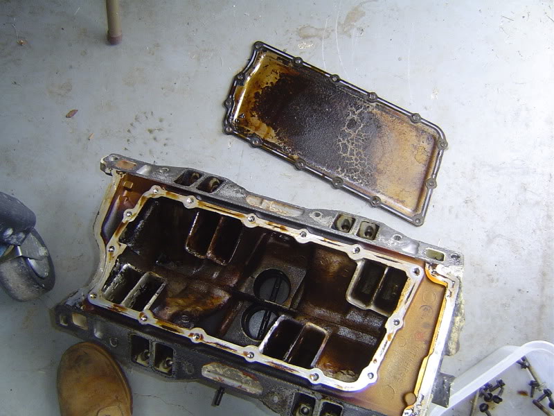

Old Jul 26, 2009 | 01:51 PM
snooked321's Avatar
snooked321
Joined: Jul 2009
Posts: 46

Nice clean up Snook .
Install a filter between the PCV and the intake , or , it will be dirty again in no time . A leaky plenum gasket isn't the only thing that contaminates the kegger .
Cutting the rail is very time consuming , but if you look at how the injecter sits , there is room for improvement there via a dremmel tool . Makes for a better spray pattern in the combustion chamber . I did it on my jeep which works fantastic . And get new o-rings for the injecters too .
