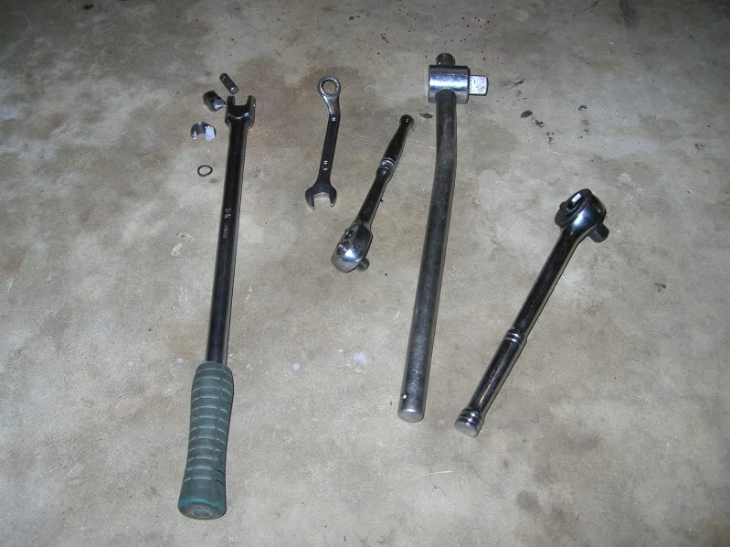

Well I got-r-done without any more trouble. This was probably one of the easiest fixes I've done on this truck, and it would have been a lot easier if I had the proper tools. 1/2" and 3/4" drive breaker bars just won't cut it. I broke two 1/2" breaker bars and maimed a 3/4". I finally went and borrowed a friends 1" drive breaker bar and the rest was a piece of cake. Everything in the picture below was broken over the course of this repair.
Truck drives GREAT, no popping or grinding at all. It's a whole lot easier to steer now too. Thanks for all the help guys!
