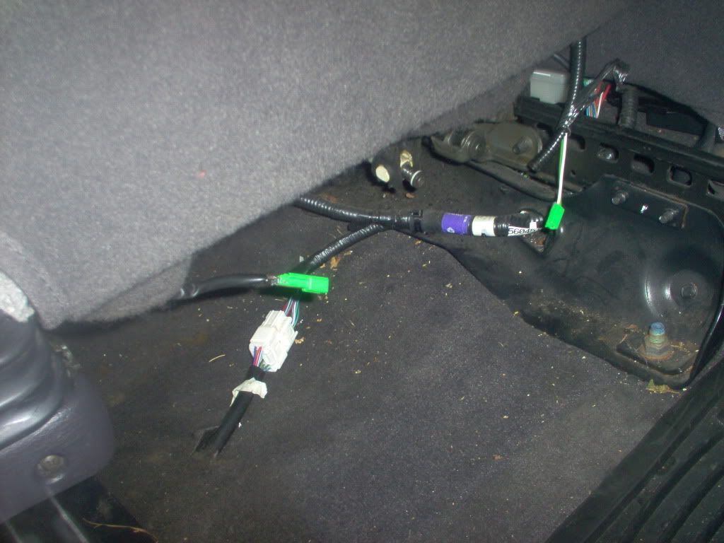

I went ahead and gave this a try today.

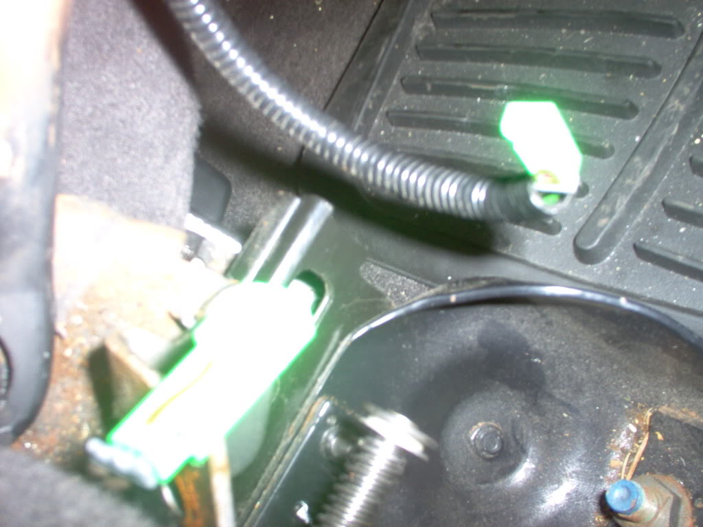

I was a little nervous, as I didn't know what was going on with the heated seat. But its just 2 plugs on each seat.
It was definetly a little harder with the power seats to get the seat bottoms lined up with the holes, because the mounts pivot.
The only issue I had, was that the plug for the heated seat backs were on opposite sides after the switch.

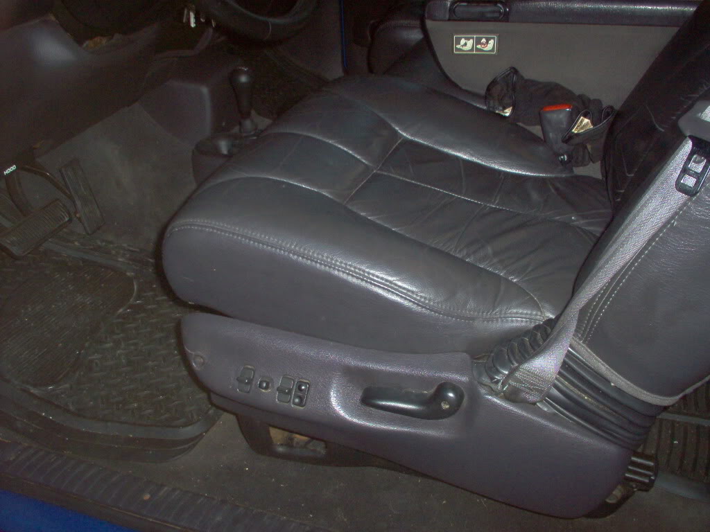

And here is the seat the way it should look.

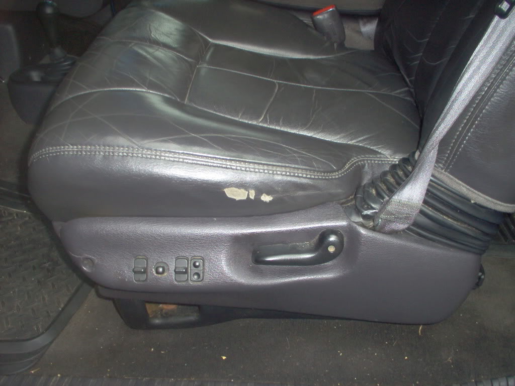

For me it solves 2 problems the leaning seat and the wear marks on the side, which was the worst looking thing on the truck, and it's now hidden.
