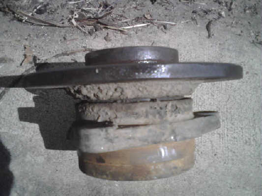

I replaced my right hub unit bearing last night and it came off with ease. Surprisingly easy actually. I think maybe the people that have major issues with getting them off are either over 100k miles and have the originals or live up north where they get a lot of winter salts and grime that cause extra corrosion.
I've attached a couple pictures in case you don't know what it looks like. This is my old one and I pounded out the studs so I can keep them as spares. The rest is now trash. If you look at the 'back' picture, it failed between the outer silver ring and the dark ring next to it. When it spins it is rough and you can feel the slop in it by hand.
