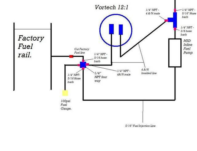

Laramie hita lot of the big items. Vortec blowers are pretty popular with the 5.2 and 5.9 Dakota crowds. Bondslayer was running one before his turbo install.
Be preparred to tap your oil pan for the return line. If its a newer one you won't have to worry about that. Definately think about tuning, SCT, Diablo or even piggy back control systems are all options.
One of the guys on Dak-dur drew up this diagram of his fuel system, hopefully it will give you an idea.
