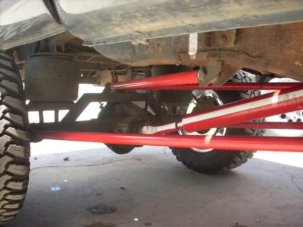

this is the setup i built for my 75, i put in a compresser and a highth sencing valve so no matter how much weight i put on it or take off, the hight never changes, i can also adjust the hight with the turn of a screw from where it is to about 5 in lower, or about 2feet higher, and no wheel hop at all
