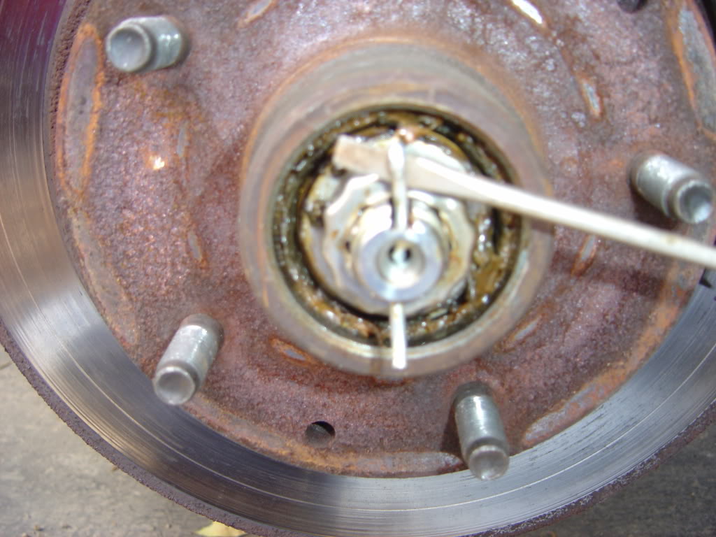

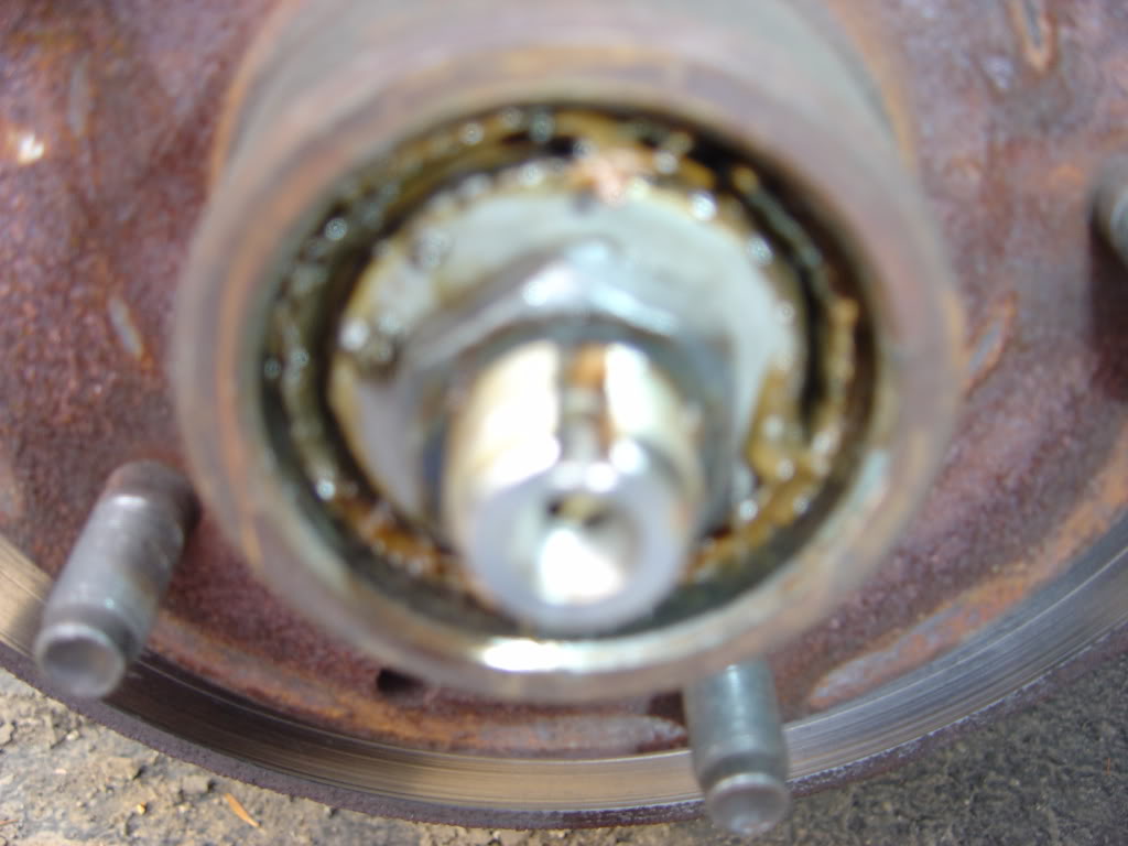

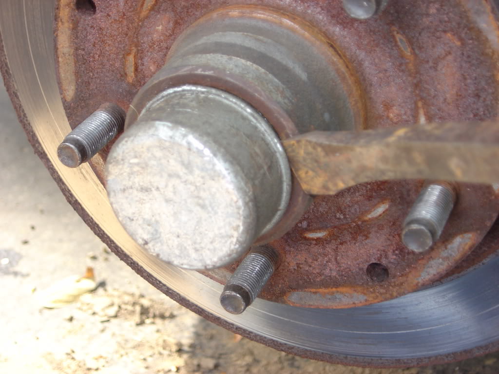

Yours are pressed on. 4x4 will just come off with the caliper.

take off the nut and take off the brake caliper and slip off the rotor

appreciate it...
whew...done. brake pads replaced and rotors machined.
thank you thank you thank you
