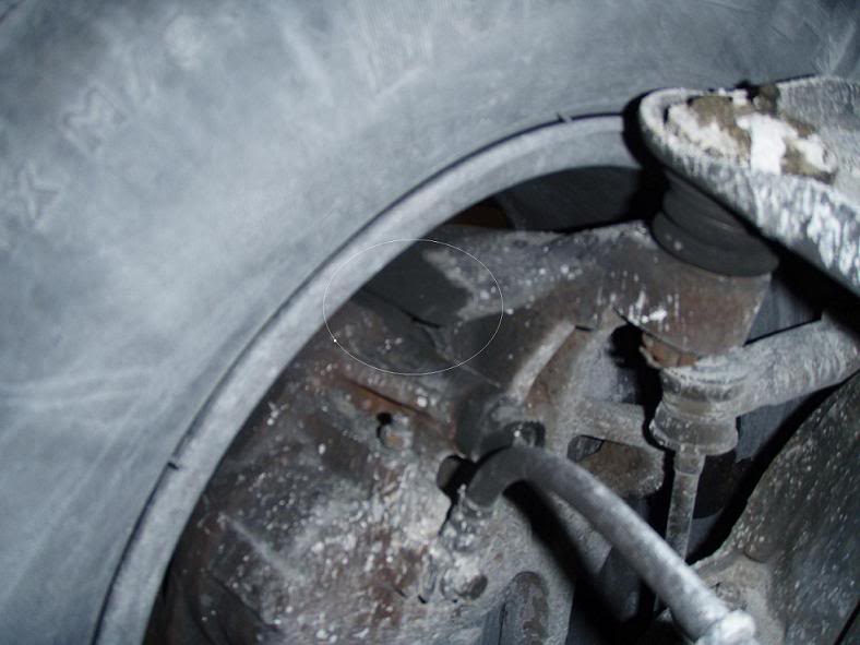

Wasnt talking about on the back of pads was talking about slides on the caliper were it slides when brakes wear,
In the circle you can see what im talking about should be some grease with the brake pads when you buy them
