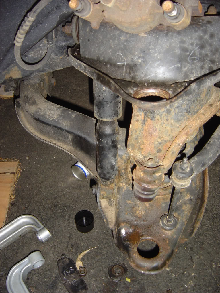

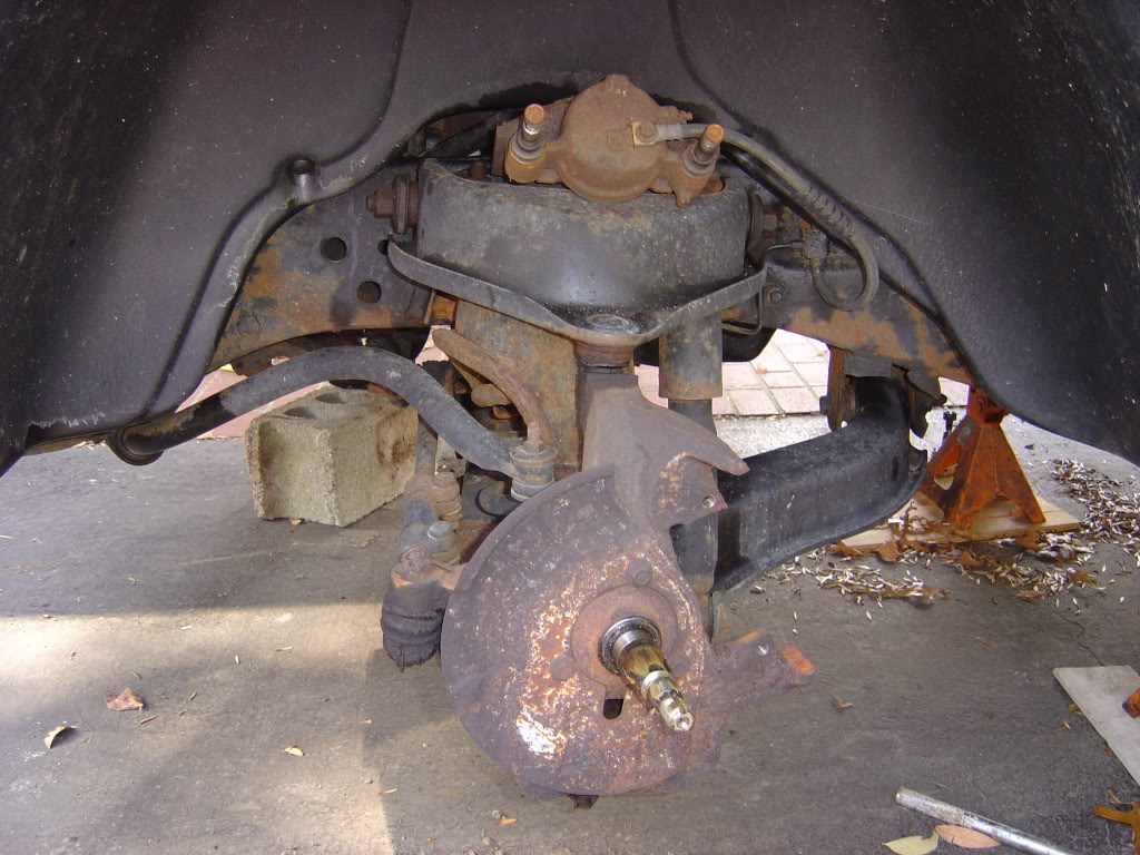

Old Dec 5, 2009 | 12:56 AM
dodgeram07's Avatar
dodgeram07
Joined: Mar 2008
Posts: 3,363
From: ohio
it stayed up there the hole time...

Well, we're talking apples n oranges.
I have always taken the whole assembly off, and that you can't perch on the control arm or hang from a wire.
There is no need to go through that length of disassembly, taking off the bearing nut/caliper/brake shoes/rotor ect, to change ball joints, unless you are doing it for some other reason, or just like to do extra work.
