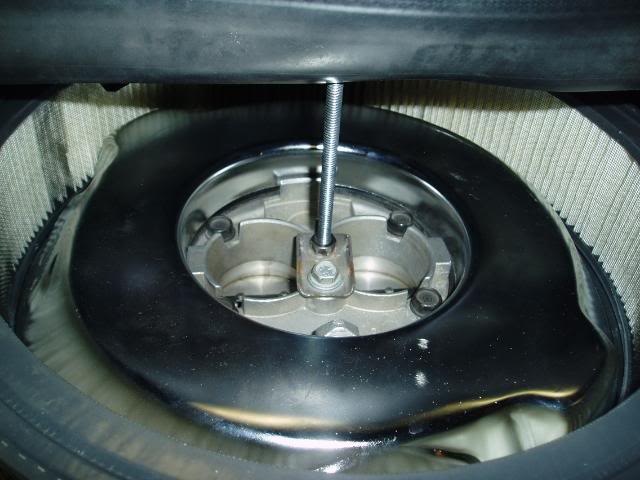

Hey Purpl, did you use a spacer with your ac or did it work without it?
Old Dec 8, 2011 | 09:01 PM
  #22
PurplDodge's Avatar
PurplDodge
Posts: 8,321
Likes: 12
From: Indiana
No spacer.

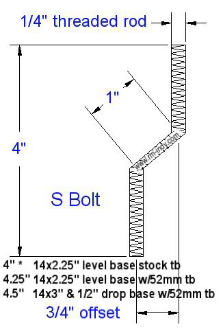

Why go through all that when you can buy some all-thread for $5 and spend 2 minutes bending it

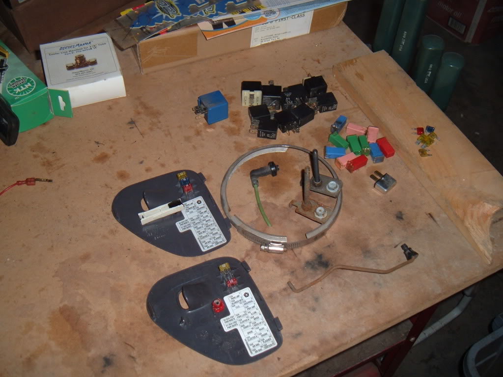

+1, and I already have the bolt adapter if you cant find one.

I guess the Ram's did not come with that? The Dakota did..

Yep, Dakotas and Durangos.

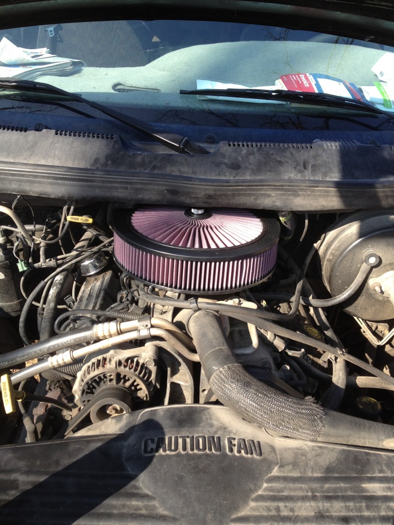

Check it out..........loud as ****!!!!!!!!!!
