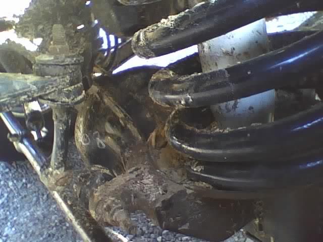

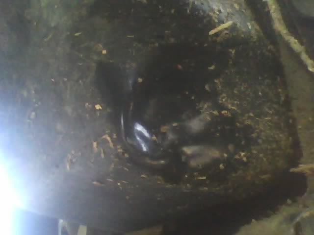

Well I looked under the truck today and guess what. Name:  Image-3.jpg
I event chopped up the bumper worse.

Dent in the oil pan.

why is the y pipe wet? is that transmission fluid?
you could just take the sway bar off until you get new links for it. olyelr has been running for like a year with no sway bar.
and if you jack the frame up until the wheels come off the ground with the sway bar disconnected on the side that isn't broken then you can push the spring back in place.
or take the wheels off and let the axle drop until the spring gets loose.
