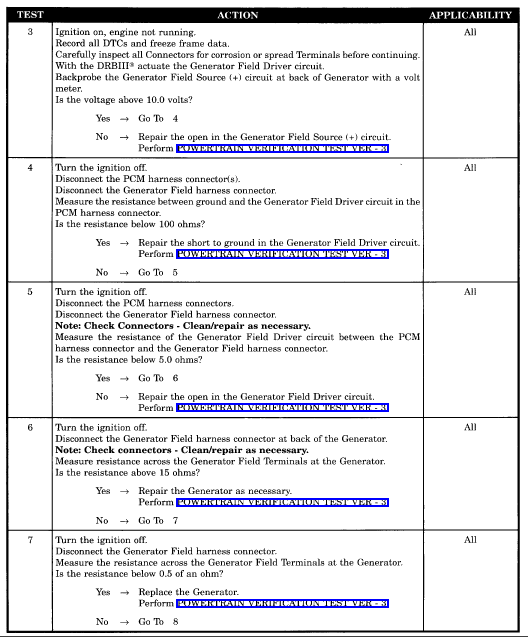

just some quick research, but it looks the the P0622 can cause all the other ones to occor. I would start with that.
SYMPTOM
P0622-GENERATOR FIELD NOT SWITCHING PROPERLY
WHEN MONITORED
With the ignition key ON and the engine running.
SET CONDITION
When the PCM tries to regulate the generator field with no result during monitoring.
POSSIBLE CAUSES
Intermittent condition
Generator field source (+) circuit open
Generator field driver circuit short to ground
Generator field driver circuit open
Generator field coil open
Generator field coil shorted
PCM
