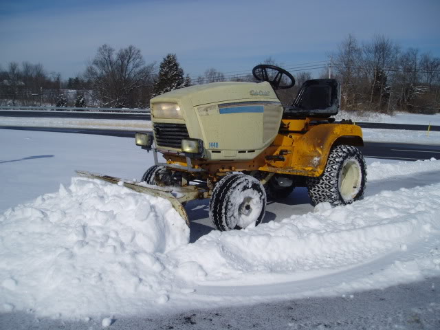

Plow size? 42'' is all you will ever need:
