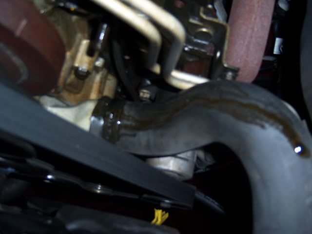

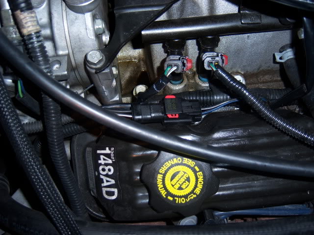

Here are the best pictures I could get at 9:00 at night.

And the WORST thing about it, is that it drips on the exhaust, and it stinks sooooooo bad.

Correct me if I'm wrong, but that looks like you front seal on your timing cover and not your rear main. Generally speaking,if your rear main was leaking, it usually drips off of your inspection cover on tranny, then to the floor.

That front leak looks like it is coming from the corner of the intake manifold. Did you use fel-pro manifold gaskets? Did you use RTV in the corners? Did you torque all the intake manifold bolts down in the proper sequence with the proper torque?

yes, in all 4 corners, and its leaking in the front and back
