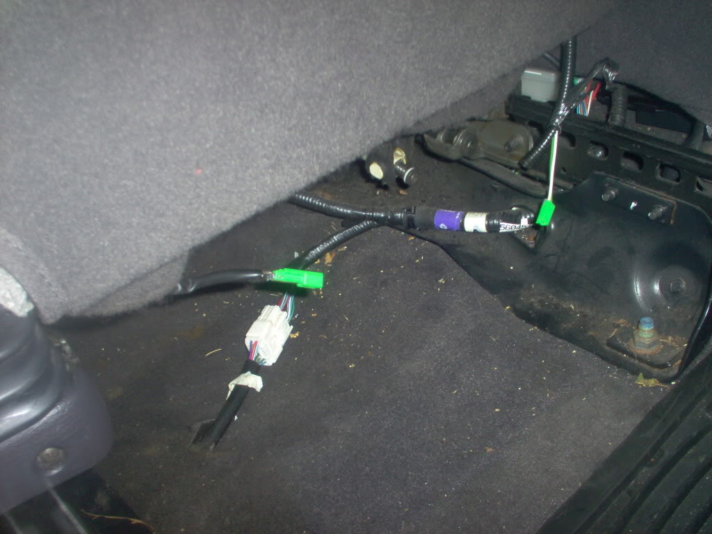

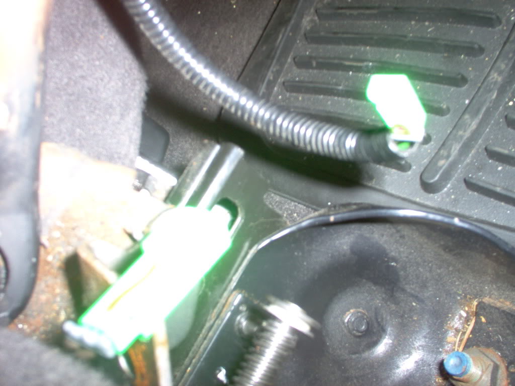

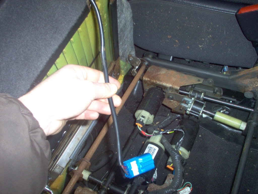

Heres my post from another thread about this.
The only issue was that the passenger seat (moved to drivers side) did feel a little higher on the left side. I think it's because that side was pressed aginst the center seat, causing the foam to be compressed differently than the door side.
It has gotten better now (like 1 month later ) from sitting on it.
heres the post with pics;
I went ahead and gave this a try today.
I was a little nervous, as I didn't know what was going on with the heated seat. But its just 2 plugs on each seat.
It was definetly a little harder with the power seats to get the seat bottoms lined up with the holes, because the mounts pivot.
The only issue I had, was that the plug for the heated seat backs were on opposite sides after the switch.
If you pulled the wires a little, they would connect, but its a little tight for my liking, also if you put the seat back forward, it could pull the wires loose.
I just spliced in a few xtra inches of wire to solve this.
And here is the seat the way it should look.
For me it solves 2 problems the leaning seat and the wear marks on the side, which was the worst looking thing on the truck, and it's now hidden.

Yep, that's pretty much how mine went, but I was able to stretch the cords enough to not need lengthening.
