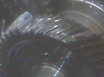

well she laid down on me a couple days ago and I took it into my buddys transmission shop, I stopped in today just as he was benching it and I watched him take it apart....and its gonna need a new cluster,2nd and 3rd gears...heres a pic of the cluster gear

another pic

0.o.. all I have to say. What happen?

it had been ran low on fluid at some point in its life, and it was a matter of time before the teeth were shape enough to start breaking, and when I loaded my trailer with 25 sq of shingles that was the breaking point lol....oh and its not a cheap fix by any means.
