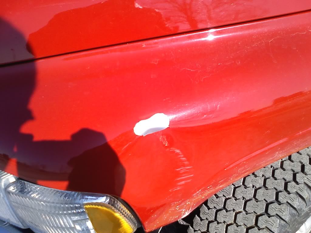

We start with this:
While I'm not sure what happened here, I knew that I had to get the hole covered up before rust became an issue.

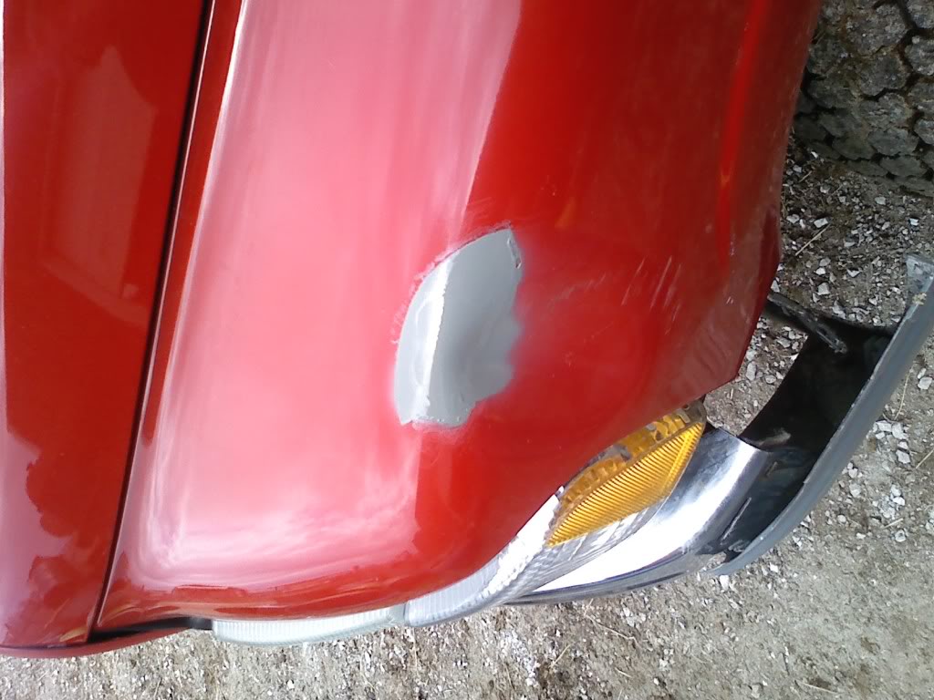

3. Use some 80 grit sand paper to feather out the paint and metal. What you're trying to accomplish is removing all the little cracks and chips in the surrounding area so they wont be there to flake off later down the road. Once you have that done, finesse it with some 320, then 600, then 1000 grit to clean up the harsh 80 grit sanding.
Below is a pic of step three done:

We start with this:
