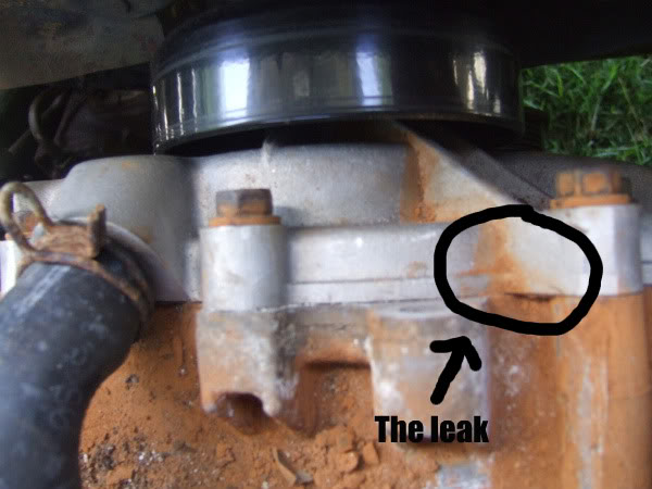

Default water pump leak????
I just installed my new water pump a couple days ago and changed out the bypass hose.I made sure all my other hoses were ok too.But I still have a small leak coming from the top of the new pump.How should I fix this?

If it were me, I'd take it off and reinstall it. MAKE SURE YOUR MATING SURFACES ARE CLEAN!!! If you didn't use RTV sealant on your gasket. Now would be the time to do so. Just a thin film on both sides. No need to over do it.

Ok so I took the new pump back off and the new seal it came with just sorta ripped in different places.So what are my options?I want to get this problem solved.And also how do I know how tight to make the bolts on the water pump?

Get a new gasket. I never use the gaskets that come with new water pumps, they are usually cheap and crappy. Get a FEL-Pro.
