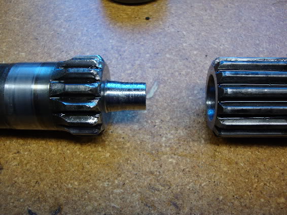

I just finished both seals this weekend. I found a bad hub bearing and both shafts on the passenger side were bad. The PO or mechanic did not put the plastic bushing in the end of the axle shaft and it hogged it out and runined both shafts. Cost me alot of $$$ for those. I also found a bad u-joint so replaced them both. Hopefully everything you have is still in good shape.
I also broke my 9/16" 1/2 in drive socket on the three bolts that hold the hub on, so used my 14mm 1/2 drive. I used quad 4x4's seal installer kit. It was very easy to put in the bushing and seals with it, if your using a socket to put them in I'd buy extras in case you get it in crooked. My carrier also pretty much fell out indicating worn bearings. You will have to take it out to replace the seal on the drivers side.

Sounds like your ready 95! I soaked the hub and spline for a few days with liquid wrench , then put plenty of anti sieze when I put them back on. You can see the picture of the CAD with only with intermediate shaft and the collar in it, and a picture of both shafts. You can see how the left shaft "nub" is worn down to a cone shape and the inside of the right shaft is hogged out also. There is a plastic bushing that goes into the right end shaft.
I had wheel hop fairly bad but I think it was a bad u joint. Even with new joints I still have a bit of hop when cranking the wheel all the way.
There are seals that go on the end of the shaft to prevent junk getting into the axle tube. One came on my new axel so I have to order one for the other side.
