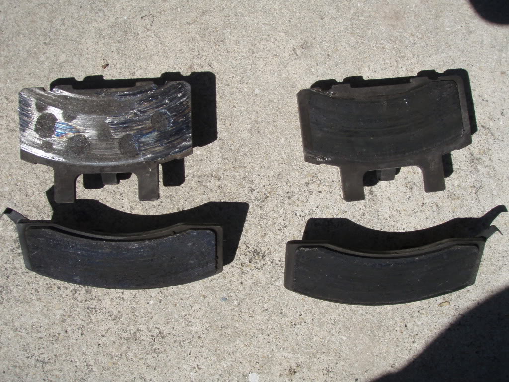

Well after hearing a loud and obnoxious scraping sound last night today I decided it was time to do my brakes before they hit the point of no return.
I spent about four or so hours including the time going to and from autozone getting and returning parts.
When I first took the tires off it didn't look too bad but I knew the problem was not able to be seen so easily. I thought I took pics of the rotors that were in bad shape, but all I got is a pic of the pads you be the judge on if they needed replacing.

So I went to autozone and replaced my rotors under warrenty so that was free, and also replaced my brake pads under warrenty another freebie.

lookin good, looks like your caliper wasnt sliding freely since one pad is thicker than the other......did they ever squeal to let you know they were bad before grindin?

I think all the mudding and offroading gummed up the slides and the grease I used on the slides was long gone. The calipers weren't correctly sliding causing the inner pads to wear out quicker and the squealers were just starting to make noise saturday night, the grinding started on thursday(I could barely feel it in the pedal).
Didn't have time to work on them till today, but saturday night it felt like I had massage chairs because you could feel the vibration from them in the chairs, the one rotor was f'd up bad, oh well like stated this whole thing only cost me $8 dollars so I was pretty happy.
