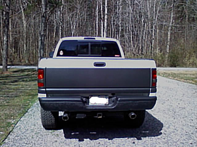

If you use Herculiner, use the UV protectant or paint over it. The sun will destroy the stuff. If you do Duplicolor, use the roll on. The can sprays too thin. It took an entire can to do my tailgate.
