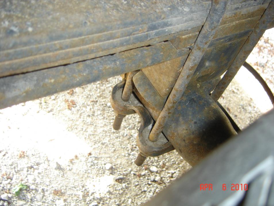

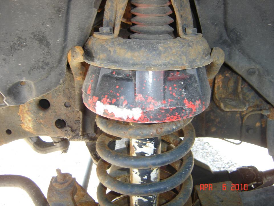

here are a couple of pics

thats a factory block in the rear, someone just put a leveling kit on it.

If the leveling kit was removed wouldnt the rear end stick up?

about an inch to 2 inches higher than the front.

sorry if i seem sceptical but i just dont see it sitting level if the front kit only was removed

The trucks don't sit level from the factory. They are trucks and meant to carry weight in the rear so it sits about 2 inches higher back there.

here's my measurements from an old thread.
here's the height of my stock suspension 4wd, on 285-75-16, which are about 32" tall with about 50 psi of air.
measured from concrete floor to wheel well lip, at the center of the tire.
front - 38-1/4"
rear - 40-3/4"
and the rear has 3" blocks.

Ok bear with me,so taking the level kit out is just a matter of taking the cup that the front springs sit in out and droppng it down

yes...
edit - here's the installation instructions from one brand.
http://www.tuffcountry.com/NewFiles/32900.pdf
