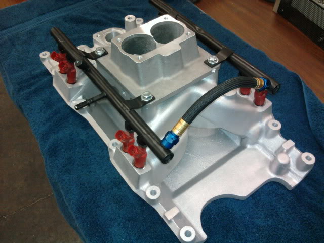

Finally. Iw as also able to remove all the stock coolant fittings from the old manifold and reuse them since I was not a fan of the brass home depot style fittings i received with the kit.
Did that FI runner come with the intake? That's pretty cool. The more I read about you people running that Hughes intake, the more I'm thinking of installing one in my truck.

noneed117
Where did you get the hose for the fuel rails. That looks really sturdy compared to the one that came with the kit.

I reused the stock fuelr ails and silver soldered new mounts on considering the ones they give are erector set quality. I also cut of the old line because I do not trust that piece of **** hose they send you to remake the fuel rail cross over. I soldered -6 fittings on the fuel rails and the hose came from Brown and Miller racing solutions. They do all the nascar hose.

I wish you had more detailed photos of the fuel rail setup.
