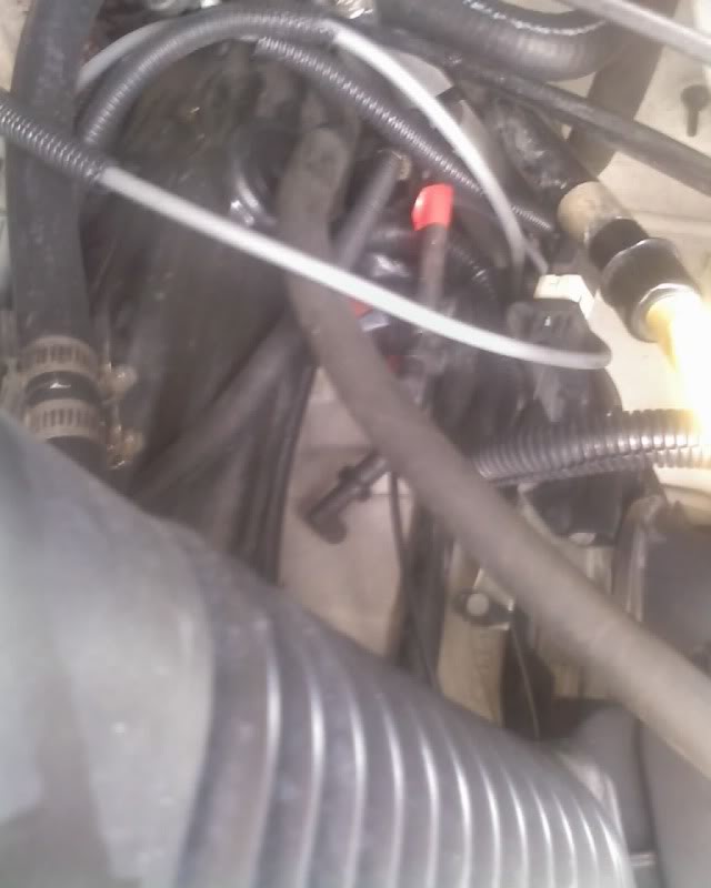

Ok, I hope this helps:
This is the left -upper side of the firewall. The connection on the left goes to the vacuum reservior; the next one goes through the firewall to the climate control system. If you continue to follow the line to the right, it connects to the main vacuum line. There's a heater hose and some spark plug cables running under the vacuum line.

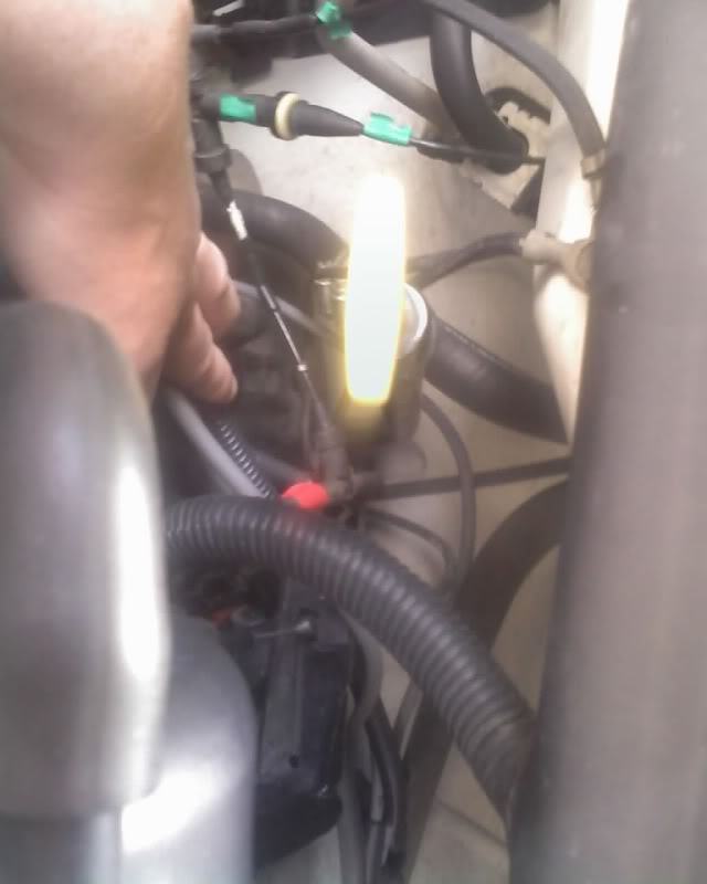

This pic shows the left side of the kegger (left side, facing the engine). It makes a 90 degree turn and heads to the rear of the engine. Right after the 90 is a Y connection that connects to the cruise control. The Y is just before the red fuel injectors in the back ground. The main vacuum line continues over the fuel injectors.

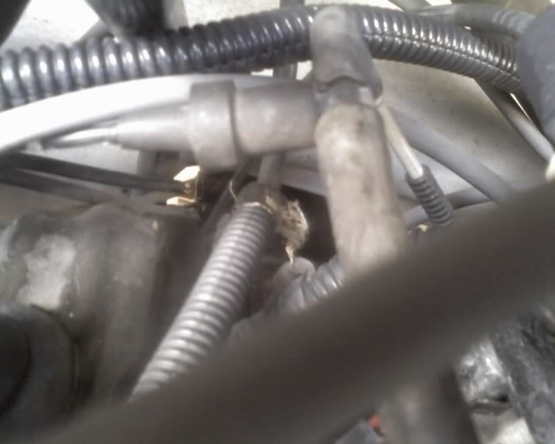

At the very top of this pic is the connection for the 4x4. It's plugged into the end of the main vacuum line. The connection that goes off to the left is the line pictured in the first photo. There should be three connections there: the main vacuum line, the line leading to the reservior and climate control and the line leading to the 4x4.
It's a little hard to tell the 4x4 line should be connected there because it looks like it just connects to the other line.
As far as the idle, it's bad because air is just getting sucked through the line into the intake instead of the vacuum line being capped by the 4x4 line.

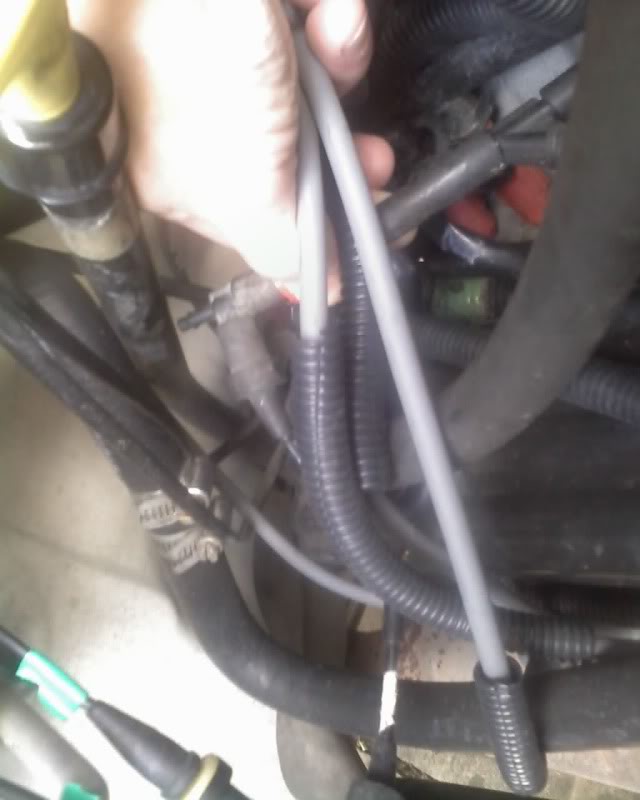

Ok, I did the best I could. If I back up too much it just looks like a bunch of wires. I put a piece of red tape on what I'm calling the main vacuum line. The line with white tape connects to the reservior and AC. The white line runs straight down.

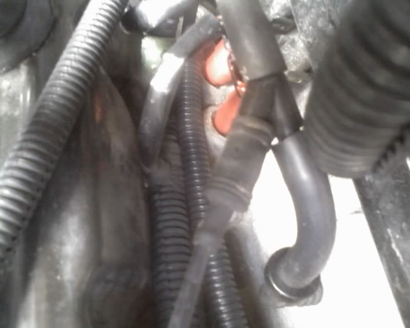

This is what it looks like with the 4x4 line disconnected.

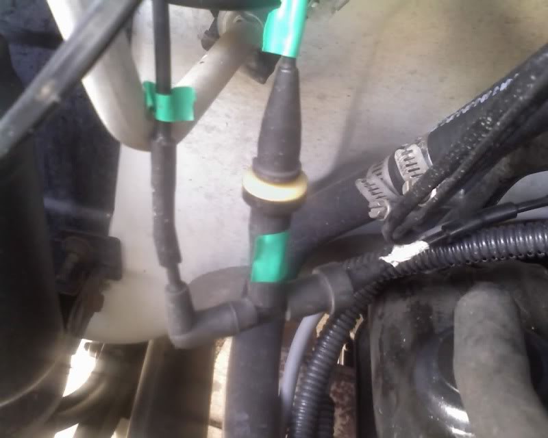

This is looking straight down on the engine. Kegger on right, valve cover on left. The air intake tube running across the bottom. The main vacuum line has the elbow going into the kegger, runs under the breather line (larger hose that goes from air hat to valve cover) runs under the spark plg wires, then the red tape, then goes to the 4x4.
