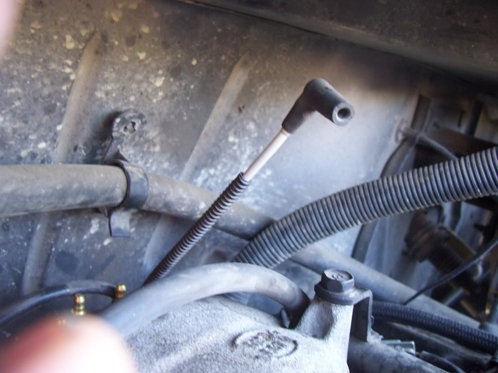

I did the plenum plate paid 14 bucks for the plate and an half hour of work all done (too much scotch in me to buy something I can make) any way all went smooth on the install until I found a vacuum line I do not remember seeing when I torn it apart so was wondering if someone could tell me where it goes? it's not regular line it is hard white plastic type with a 90 degree elbow on the end and appears to run down the back of the motor. Also changed out the governor pressure sensor added a drain to the tranny all in all everything went very smoothly just have to run the new plug wires and go get a tb gasket (i forgot to get it) and see how she runs

Sorry did not think of taking a pic or two. I only remember seeing 3 vac ports on the keg all 3 are hooked up also the 1 on the tb is hooked up this line is maybe only 1/8" dia. at most maybe smaller
Looks like the white line that goes down to the transfer case to engage the front axle.

Thanks purple but do you know where it hooks into on the motor I am not finding any open ports

Top right of the engine towards the back, will be either a 3 port or 2 port black silenoid

Trace the vacuum lines from the intake manifold back to the firewall. One of them will have a stub which that line is supposed to plug into.
