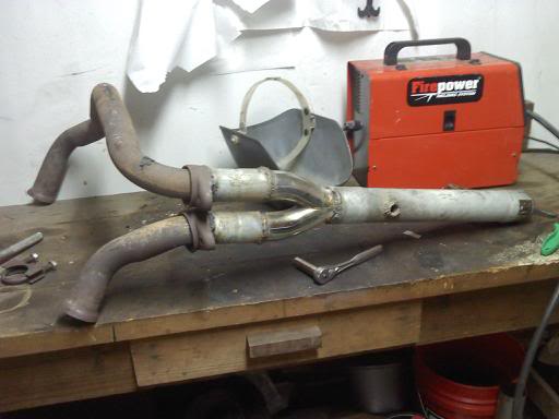

From: ohio
hell buy a cheapo $100 wire feed welder......... and if you want to be a jerk then take it back
put the exhaust on then just weld the cat to the header pipes then drop the y-pipe and finish welding thats what i did...........not the jerk part and not the cheap welder
