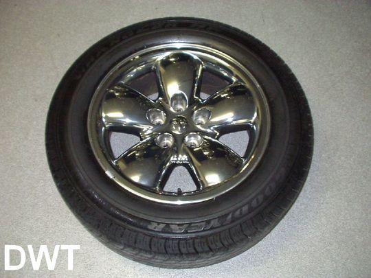

i have a 1999 dodge ram 2wd and just bought the stock 20" rims, my back fit on good, but the front rims are hitting the hub or something and wont go on I have a 2wd so thast probably why, how did you make those rims fit??please help

yours are chrome correct? they made a polished aluminum version of those as well that will fit, yours either need machined or a spacer

What size of the spacer disc like a 1/4" or like a 1" spacer with lug extenders

i believe 1/4" is all thats needed

I just don't get a a small spacer will stop the hub from hittitng the inside whole and give me enough lug space the spin the nut on

Im not sure what size spacer you need but If you put the rim on and measure the distance between were the rim gets stuck and the seat point on the hub you will know what size spacer you need, without the guess work

the 1/4" spacer did nothing the rim is still hitting the hub
