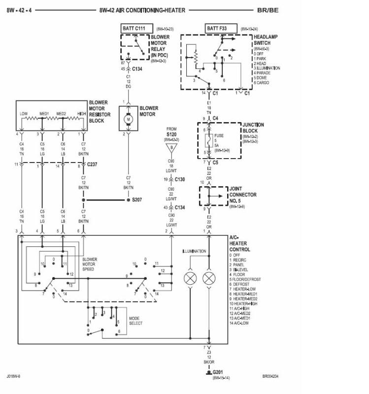

Have a wiring diagram.

WOW! thanks Brian. This will make crawling under the dash easier for this 55 year old pot bellied white guy. No excuses now. I'll start this evening. I've got a line on a dash control switch from a salvage yard for $35. If it's needed. Thank you again.

One thing I have noticed about dodge.... switches and controls tend to provide GROUND to an already powered circuit, rather than power to an already grounded circuit. So, Checking for where power is LOST, you need to start at the END and work your way back toward the switch, and its final grounding point.
I knew things seemed odd...... I am used to GM.
