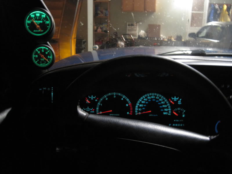

Gauges are all in and working! After 15 miles of freeway driving in 65* weather the tranny temp never got above 125. I'll have pics up tomorrow night when I get home from the dunes.

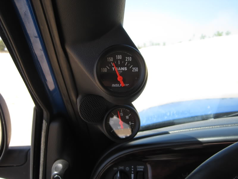

Seems like having the sending unit in the servo port works just fine. I spent all day beating on the tranny at Silver Lake sand dunes and the temps never got above 180*. I'm very happy with this mod.

nice job!! paint looks great does it make to bind spot bigger?
Old May 25, 2010 | 12:16 PM
CSXfan's Avatar
CSXfan
Posts: 770
From: Southwest Michigan
Not really, I don't think the blind spot is any bigger at all. So far I'm very happy with this mod, I get lots of compliments.
