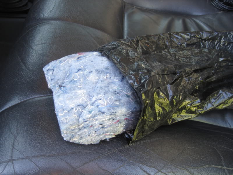

I found this jammed in a hole behind one of the interior trim panels. THIS is Chrysler's way of insulating the cab? Nice...

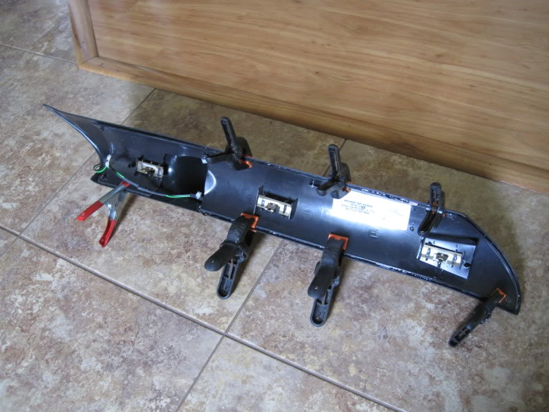

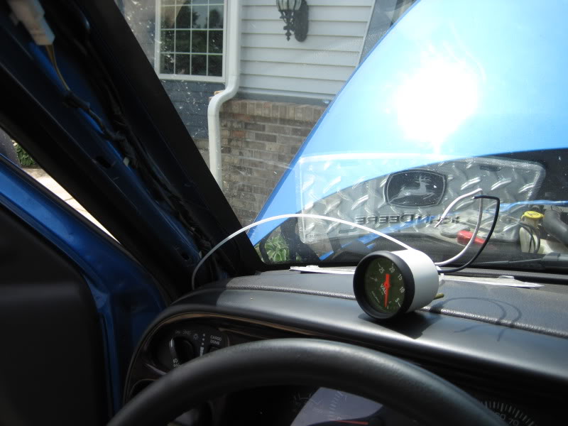

Next I wanted to install a set of pillar gauges. I wanted to be able to keep track of my tranny temp while cruising around at Silver. (I know more than a few people that have cooked a tranny on the dunes, I don't want to be one of them) I couldn't find a full pillar that had a space for a single gauge, so I had to get a dual setup instead. I ended up getting a vacuum gauge because it was the cheapest and easiest to install, plus it will come in handy when I decide to fix the multiple vacuum leaks my truck has.
Here's the new pillar waiting for the glue to dry.

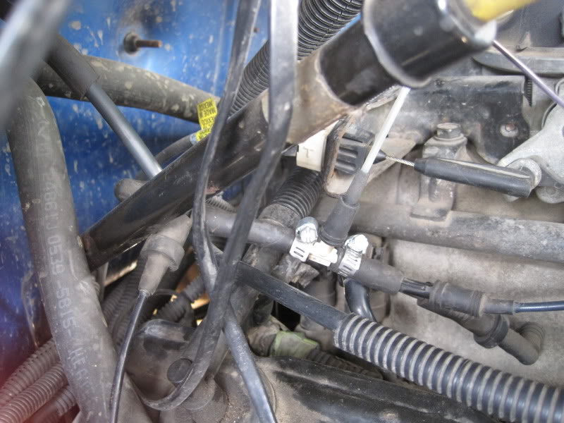

I already hooked the vacuum gauge up. It was simple, only took about 5 minutes.
I can't wait to get this finished, I think it's gonna look great. Hopefully I'll finish up the gauge install after work tonight, I'll update this as I progress.

how many gauges are you doing and for what ?? looking good man !

cant wait to see that pillar done

thats a bad a$$ looking pillar where did you get that from? i want to do a tranny and a mini-tach.

You'll get bogus vacuum readings from downstream of the check valve where you've tapped the line.
I guess it's okay where it is if you want to know what's happening at your cab air vents, but if you want true manifold vacuum you'll have to move that tap to be upstream of the first check valve.

I'd love to add at least a tranny temp gauge to mine, same as you are doing. Where are you tapping into for that?

The pillar and gauges are made by Auto Meter. I ordered them from Summit Racing.
UnregisteredUser, I do have the "possesed vent" problem, but that really isn't why I installed the gauge. Thanks for the tip.
Maxx, I'm plan to just thread the temp sensor into the front servo port on the tranny. I know it would be better to tap into a cooler line, but I didn't feel like spending the extra $40 and dealing with the hassle of installing it that way.
