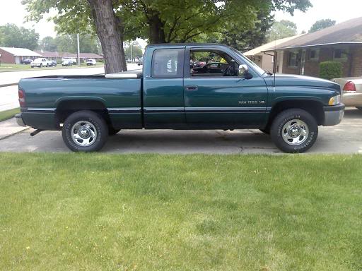

this is what i got..........40bucks and free shiping
http://www.suspensionconnection.com/...C09103D16.html
before
after
it's only a 1.5in,,,and stock shock rides the same to me
