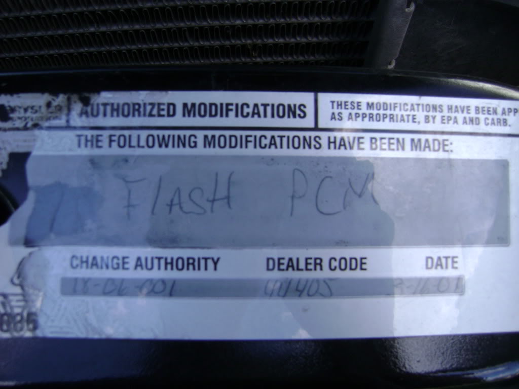

Ive been reading up on all the threads about the blown plenum and found threads about the death flash. Went under the hood and saw the Flash pcm on the label. I would like to get a new tuner but i want to make sure everything else is ok first. The truck is kinda sluggish before i hit around 2700rpm then it takes off. Its got around 100k miles so i figured the plenum was blown but i cant tell if there is enough oil in there our not. Any help would be greatly appreciated! Here are pics of inside the throttle body.
