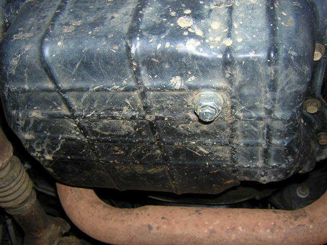

another bump with a picture.
place the plug on a flat spot, on the bottom or the side.
place it where it WON'T hit the solenoids or other internal parts.
drill a 1/2 inch hole.

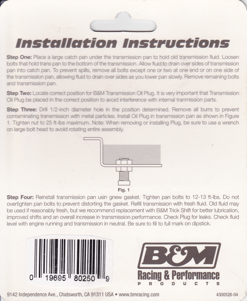

I have a B&M 80250 and one of these days I will get around to changing filter and fluid and installing the thing. Instructions doesn't show if nylon gasket goes outside or in, but I figured out. Thought about JB Weld, but will use come red loctight and it will hold.
The back of the blister card tells you exactly how to install the B&M 80250 plug.(Which IMHO is the best one to use). No JB weld or red locktite. If you don't have the installation instructions, I still have the card. And will take a pic and post it if you need me to.

Here is a picture of the only instructions. I don't see the washer, but I have been known to be looking right at something and miss it. Yes I can tell since I opened the packet, that nut on inside won't come off, only goes on one way and must be tapered. Name:  DrainPlugInstructions.png

The printing company screwed up, as you can see in this pic. The washer is clearly on the outside of the pan.

Thanks, they really did make an error- strange.
