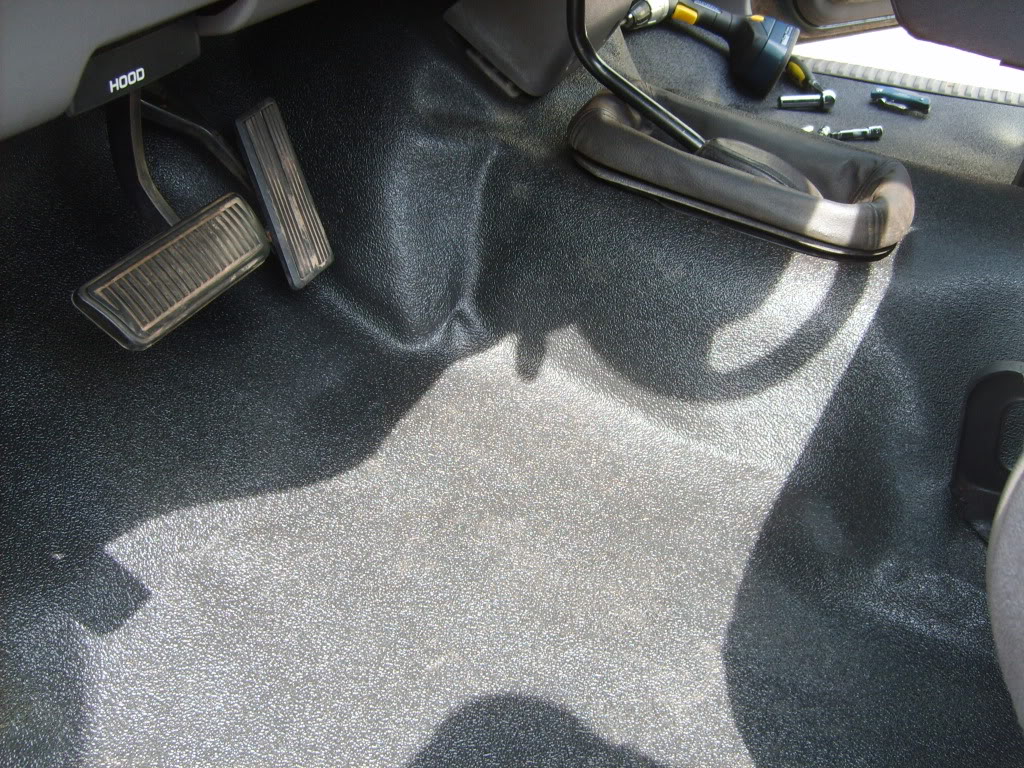

Hey Guys ......Bought a Vinyl Floor covering for my Ram . My Carpet and Soundproofing mat. was rotting the floor as it never gets a chance to completely dry....and with the salt the use in the Canadian winters had begun to eat a large hole in the floor. I fixed the Hole with 1/16" satin coat steel, seam sealed it and then used rust check bedliner on the entire floor. I bought the vinyl at stockinteriors.com . I will be fitting this tomorrow and will post pics. I am also getting my Efans, Hughes Plate and Pacesetter longtubes delivered this week and will post some pics once installed.

Default Some Pictures
Gonna run 3" with Magnaflows .....might go up over the rear axle out of sight.....I have them coming straight out the back now....but they keep getting smashed on rocks when I'm wheeling in the woods.

Old Jul 28, 2010 | 10:39 PM
lastrights's Avatar
lastrights
Joined: Sep 2007
Posts: 5,849
From: the burgh
nice truck man ! im running lontubes with the cherrybomb extreme and love it !
you will be surprised how diffrent it will sound from manifolds!
i really like the stance of the truck sits nicly !

Old Jul 28, 2010 | 10:41 PM
olyelr's Avatar
olyelr
Posts: 2,032
From: Elk Rapids, MI
Looks good, love the floor!
What is that? 5" suspension, 3" body and 35's?
Old Jul 29, 2010 | 12:58 AM
nopower318's Avatar
nopower318
Posts: 283
From: Smithsburg,Md
Very nice truck, how does water keep getting in the cab? Never been a big fan of the vinyl but looks nice.
